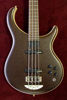

I've never worked with wenge but heard it has a rosewood sound. I remember a guy at the 2003 Healdsburg guitar fest that had a classical made of spruce and wenge. The wenge was quartered and from a distance it looked like ebony until you got 10 feet away and could see the alternating black and dark brown grain lines. I found the below picture of an electric bass on the internet - I don't know who built this, it was on a webpage showing different shots of unfinished wenge. This wenge is flatsawn and the grain is more prominent than quartersawn stock.

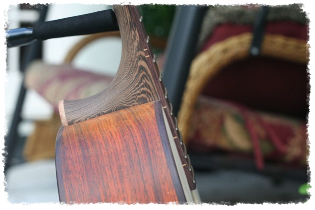

I just sent a guitar off to Addam Stark to get finished and I had used
wenge for the neck. It is very splintery wood. I use a template to route
my headstock shape and this normally takes me under 10 minutes to
approximate the shape on my bandsaw and then route away the rest on
my router table. Well, I spent a good hour or so getting the shape right
up to where it needed to be before I took it to the router table. It is also
extremely dense and made the heel area much harder to carve. But it is
beautiful wood and has a great tap tone. I am looking into building an
adirondack/wenge guitar in my next batch.
I would recommend it but just be aware that it does like to splinter along
the grain. So when you route the binding ledge, I would take a lot of
precautions to avoid tear out, especially on the lower bout where you are
cutting only end grain.
But it is a beautiful wood under a finish. Here is a picture of the neck:
Simon

simon, the guitar looks gorgeous!! hope to see it once the finish is done. thanks for the adivce. maybe i'll even go as far as watering down some titebond and shmeering that around the perimeter a few days before i route the channels.

Simon, that wenge neck looks awesome!!!

And doesn't that bass that John pictured look great?
Steve[/QUOTE]
Yes, and yes!!! SniderMike39021.0380787037

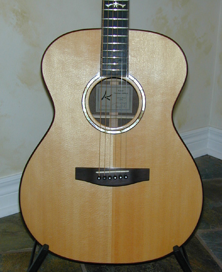

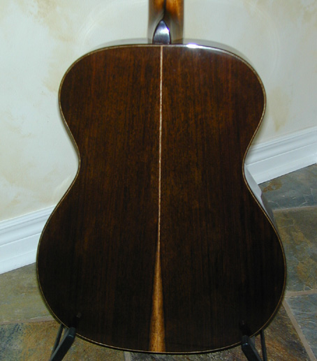

Here is the OM .. looking thru the pix I also found/remembered that I made a long scale parlour venetian from the same board. This one is bound on wenge as well, and the purf is blk/red/blk, the rosette is gold MOP. Bridge is afr blackwood, the neck has been stained darker to match the back a bit better. I usually dont do that, but this one I tried it out. Just going to show you never know what you might find, that is an A grade top, but shows lots of pretty shimmer ... cheap too !!!
